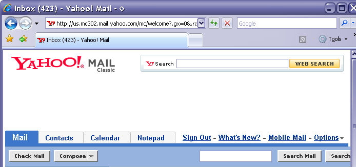

There is one drawback though. The last line adds a lot of empty space in Yahoo page. Compare two images:
.png  Yahoo-01.png (Size: 20.14 KB / Downloads: 804)
1-st was taken without the line
.png  Yahoo-02.png (Size: 22.55 KB / Downloads: 758)
and the 2-nd one when the line is added. It's not a big deal, but I think it can be fixed.
