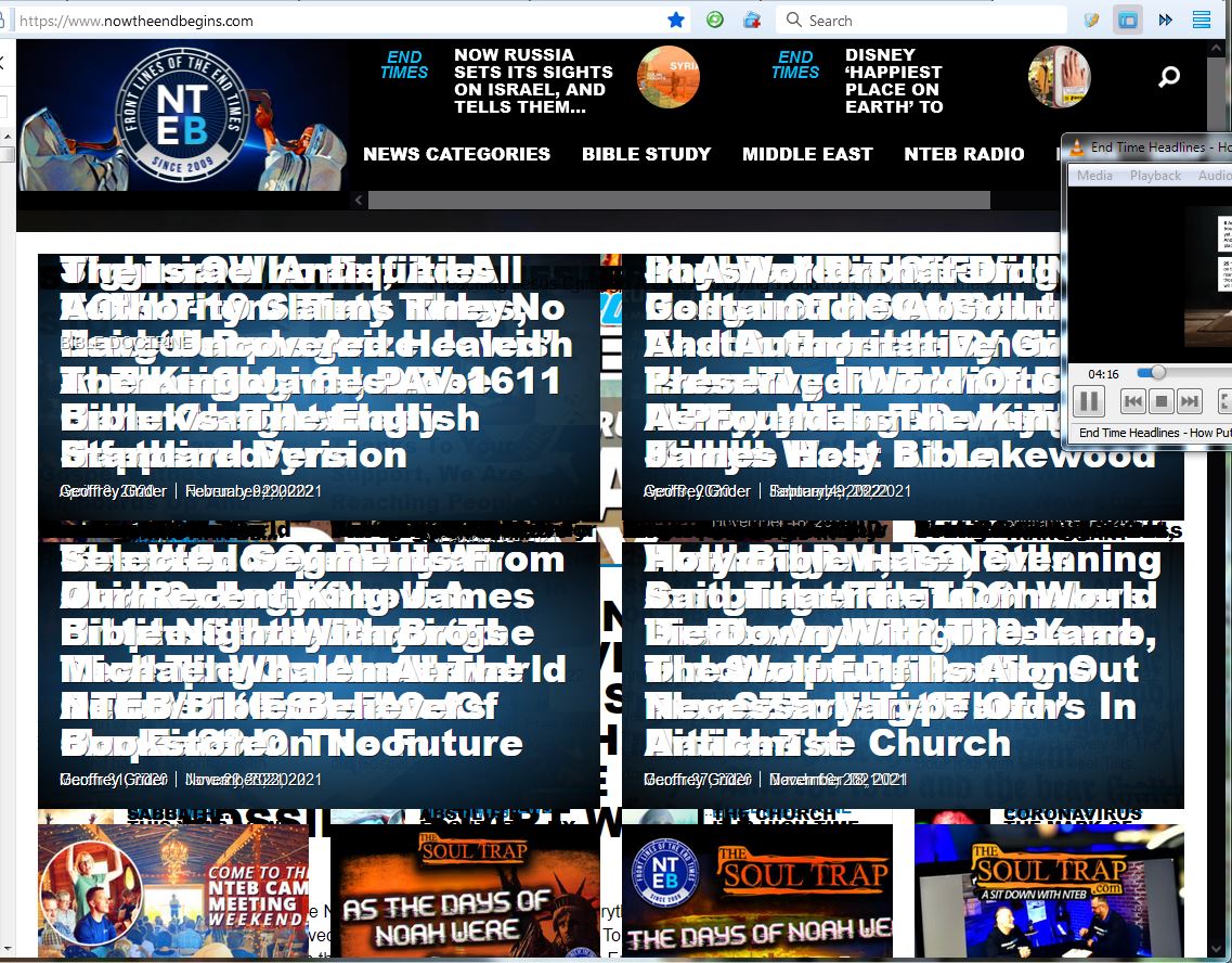

I was just wondering if someone had a fix for this website. If I right click and put Proxomitron in bypass it works fine, but if I don't do that, then the text on the website is unreadable. I tried adding the site to the Bypass List.txt, but it's still unreadable if I do that. I attached a photo below to show what I mean. Thank you for any tips !
https://www.nowtheendbegins.com/
.jpg  Capture .jpg (Size: 288.37 KB / Downloads: 325)

Here are a couple of options for you.
1) Use the Proxomitron Menu in the lower right corner to temporarily BLOCK scripts when visiting that page
2) Use an extension such as eMatrix or Proxomitron's block lists to block scripts from t4x3y5r8.stackpathcdn.com (I'm showing 33 of them!)
3) Debug all 33 of those scripts and isolate specifically what needs filtered (will likely be a bit time-consuming if you opt for this route)
Feb. 25, 2022, 04:21 PM (This post was last modified: Feb. 25, 2022 04:22 PM by JJoe.)
RE: Unreadable website...
For me, adding
#https://www.nowtheendbegins.com/
t4x3y5r8.stackpathcdn.com/wp-includes/js/masonry.min.js?ver=4.2.2  $SET(0=a_jsprop.)
to IncludeExclude-U cleared it up.
Adding
t4x3y5r8.stackpathcdn.com/wp-includes/js/masonry.min.js\?ver=4.2.2
to the bypass list may also work.
Adding an address to the bypass list only bypasses the address that match the entry. It does not bypass all the addresses used by the entry.

...that WORKS JJoe. Wow, thanks for fixing it for me, now I don't have to manually put Proxomitron in bypass every time I visit that site ! I appreciate you, and thank you for your input as well ProxRocks !

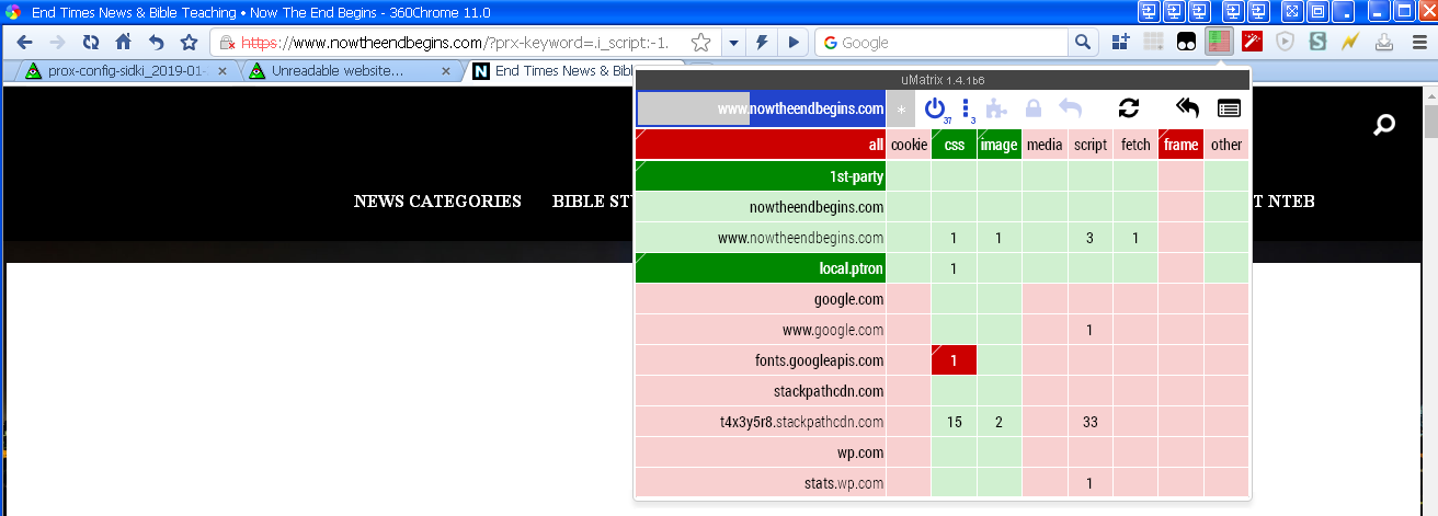

I tend to let uMatrix do the counting for me - much more accurate.
Proxo Menu will do a count but it will not break that count down by domain, it includes Proxo's own injected scripts in the count, and it includes scripts that are blocked in the count - very misleading.
.png  2022-02-26_21-54-29.png (Size: 61.86 KB / Downloads: 297)
