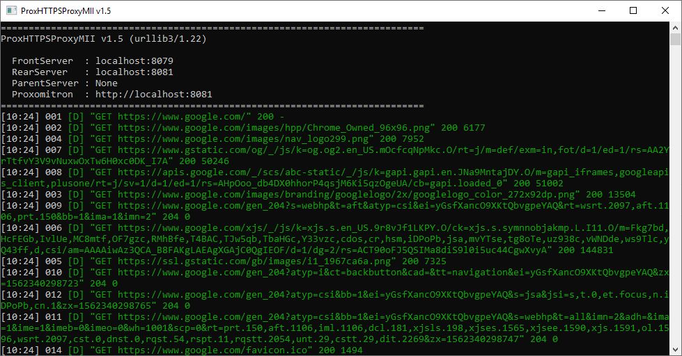

Check your config.ini. edit.
ProxAddr = http://localhost:8081
Should cause the console to show
Proxomitron:https://localhost:8081
You want the ProxHTTPSProxyMII console to look something like
.jpg  MIIonlyconsole.jpg (Size: 135.18 KB / Downloads: 655)

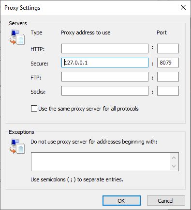

Your IE proxy settings should look like
.jpg  MIIonlyIEProxySettings.jpg (Size: 22.64 KB / Downloads: 676)

I made the changes to the IE proxy settings so they now match.
