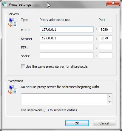

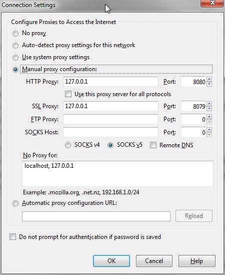

(Feb. 05, 2015 07:37 AM)SharkyEXE Wrote:  2) Please see you setting proxy in browser Opera or Firefox or Chrome or other
.jpg  Firefox35.jpg (Size: 42.1 KB / Downloads: 802)
.jpg  IE11+Opera27.jpg (Size: 24.91 KB / Downloads: 767)

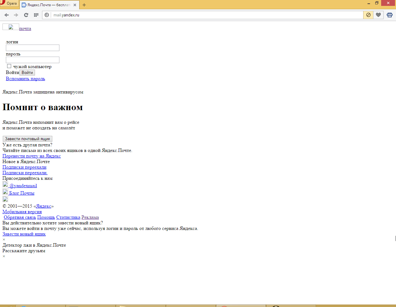

18) In browser Opera 26.0.1656.60 I configured Proxy setting what on this picture:
.gif  2015-02-06_03.gif (Size: 168 KB / Downloads: 778)

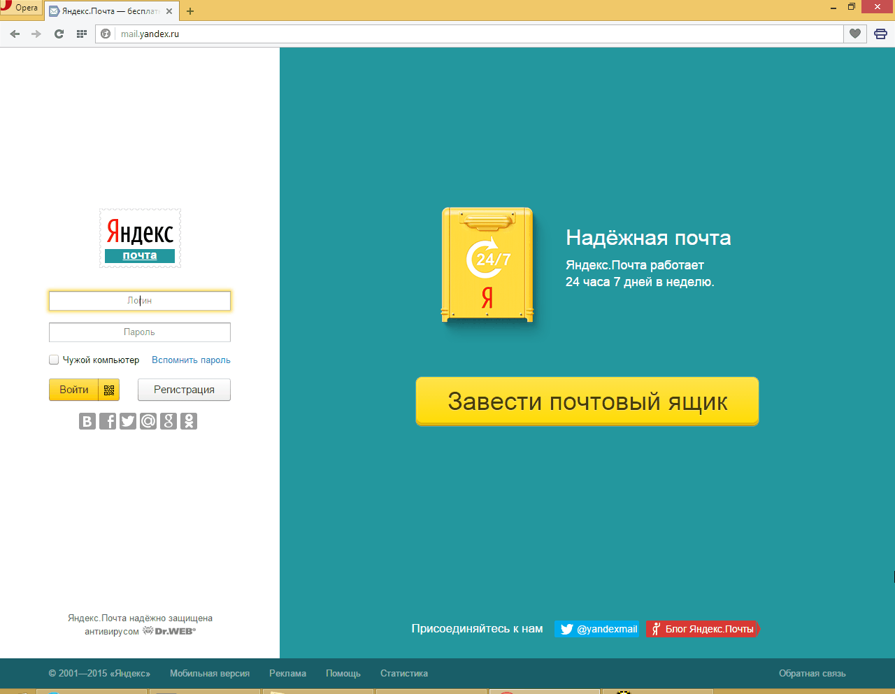

19) In browser Opera 26.0.1656.60 I go to https://mail.yandex.ru/

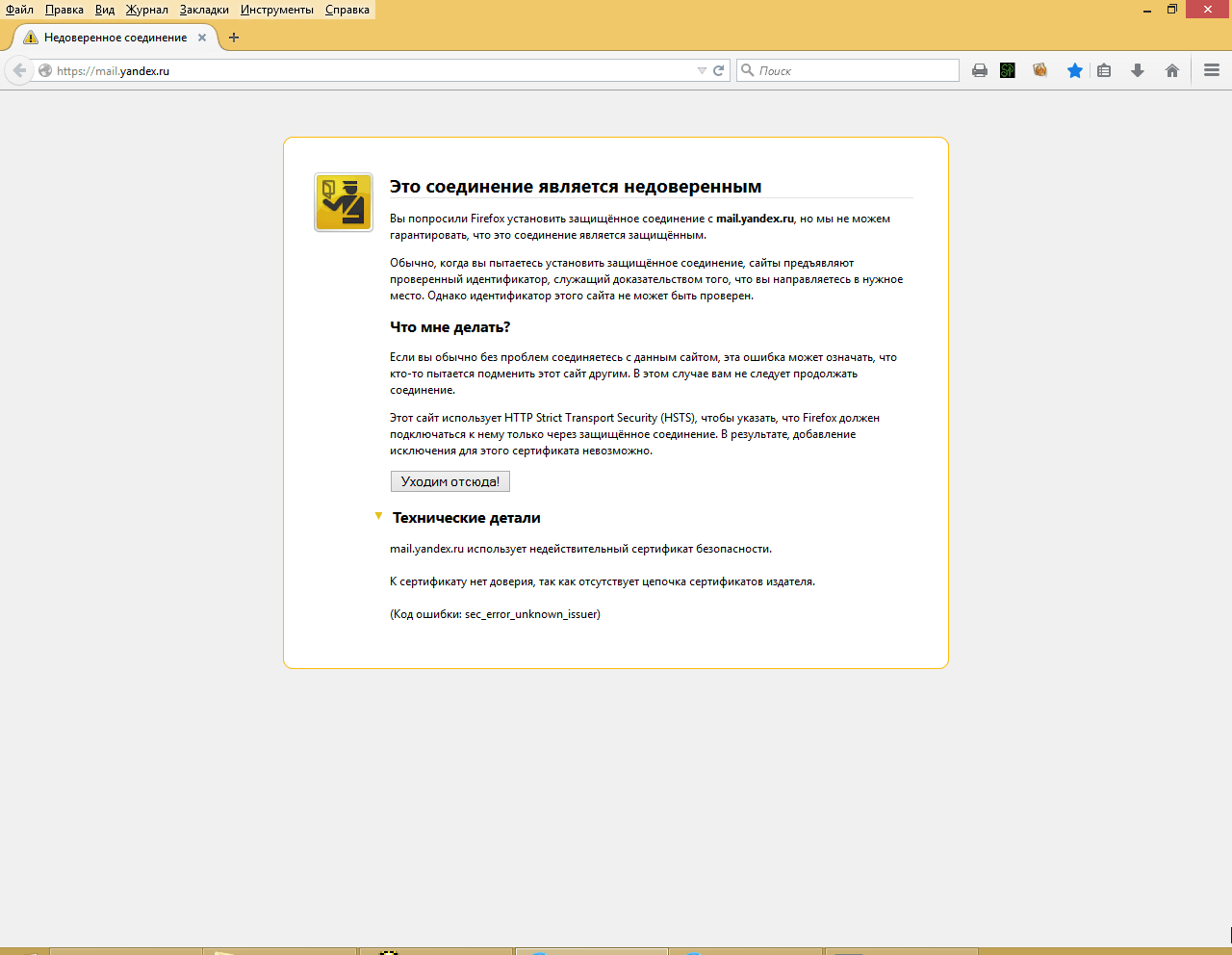

20) I see this:
.gif  2015-02-06_04.gif (Size: 37.53 KB / Downloads: 756)

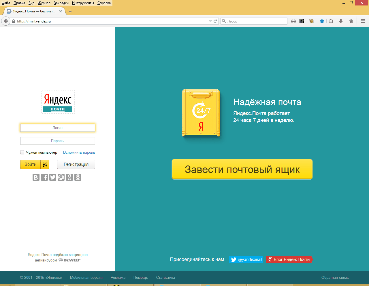

21) In browser Opera 26.0.1656.60 I disabled Proxy setting
22) In browser Opera 26.0.1656.60 I go to https://mail.yandex.ru/
23) I see this:
.gif  2015-02-06_05.gif (Size: 54.84 KB / Downloads: 759)

20) I see this:
.gif  2015-02-06_07.gif (Size: 38.64 KB / Downloads: 750)
21) In browser Firefox 35.0.1 I disabled Proxy setting
22) In browser Firefox 35.0.1 I go to https://mail.yandex.ru/
23) I see this:
.gif  2015-02-06_08.gif (Size: 56.5 KB / Downloads: 691)
Question 1
What:
1) If In browser Opera 26.0.1656.60 I configured Proxy setting what on this picture:
2) If In browser Opera 26.0.1656.60 I go to https://mail.yandex.ru/
I see this:
Question 2
What:
1) If In browser Firefox 35.0.1 I configured Proxy setting what on this picture:
.gif  2015-02-06_06.gif (Size: 100.18 KB / Downloads: 761)
2) If In browser Firefox 35.0.1 I go to https://mail.yandex.ru/
I see this:
Please, help me, what am I doing wrong
Thank You!
Feb. 06, 2015, 04:26 PM (This post was last modified: Feb. 06, 2015 04:30 PM by JJoe.)
Post: #98
RE: ProxHTTPSProxyMII: Reloaded

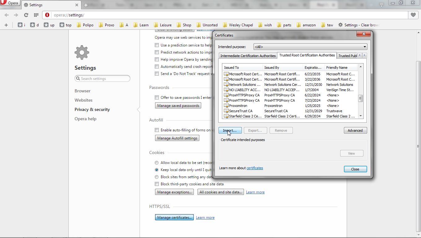

(Feb. 06, 2015 05:25 AM)SharkyEXE Wrote:  Please, help me, what am I doing wrong
Did you add ProxHTTPSProxyMII's "CA.crt" to the browsers' store of trusted certificate authorities?
"CA.crt" is in the ProxHTTPSProxy's folder.
.jpg  CertImportFirefox.jpg (Size: 87.9 KB / Downloads: 698)
.jpg  CertImportOpera.jpg (Size: 124.67 KB / Downloads: 728)

1) I don't add C:\Program Files\ProxHTTPSProxyMII\CA.crt in Opera 26.0.1656.60 and Firefox 35.0.1
Thank You, I add C:\Program Files\ProxHTTPSProxyMII\CA.crt in Opera 26.0.1656.60 and Firefox 35.0.1, now it work

In which section in file C:\Program Files\ProxHTTPSProxyMII\config.ini I add line, for example
https://disk.yandex.ru
to the site https://disk.yandex.ru worked fast?
Addresses in [SSL Pass-Thru] are not modified.
Addresses in [BYPASS URL] are decrypted. May be blocked by ProxHTTPSProxyMII's [BLACKLIST].
To 'work fast' you probably want to add *.yandex.ru to [SSL Pass-Thru] section
or add address to browser's "Do not use proxy for" field.
Edit: spelling

that site is *VERY* slow !!!...
i'm showing 4 to 5 second load times (unacceptable in my book Smile! )
drops down to about 1.5 seconds if the images are already cached
drops down to UNDER half a second if you block all of the images
so i'd say your "site-specific" fix would be to block the huge surfboard and phone pics
also, the "What the Proxo is thinking" page is showing FIVE huge "mp4" files with a length of OVER 1,600,000 - is that 1.6 *gigs* each ???
seriously, downloading 8 *gig* of data on ONE web page ???
that's just STUPID, assuming that the "length" is a "byte"

(Feb. 09, 2015 12:00 PM)ProxRocks Wrote:  so i'd say your "site-specific" fix would be to block the huge surfboard and phone pics
I wonder... The way I read it SharkyEXE found yandex was acceptable without proxies.
@ SharkyEXE
Blocking unnecessary files by adding the files' addresses to the ProxHTTPSProxyMII's [BLACKLIST] section should make yandex faster.
Blocking or caching those files with the Proxomitron should make yandex faster.
Let us know, if you need help.

More and more often I am getting certificate failures. Isn't there any way to just tell it "I don't care about certificates, just do it"? I can't keep tracking down and adding to the cert.pem for every site that forces me into SSL...
