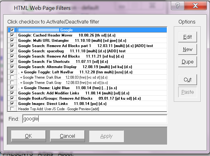

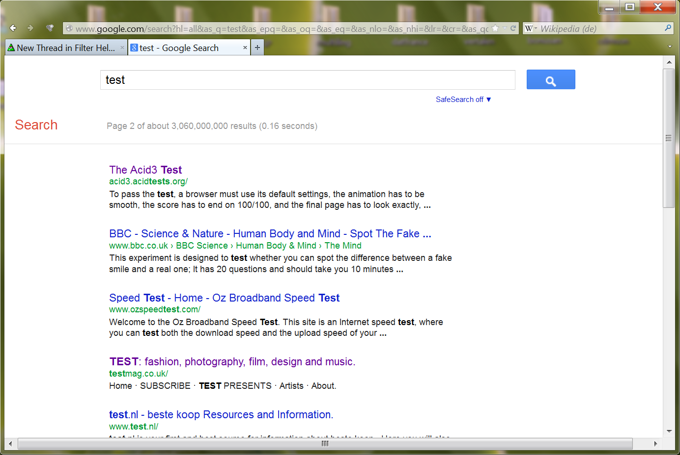

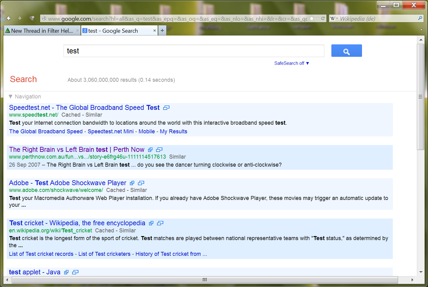

Recently, I have problems with the Proxomitron filters for Google in Firefox 15 under Windows 7 32 Bit. I am using the Light Blue Theme and Toggle Left Bar filters, which worked absolutely fine in the past. This changed last week or so, probably after a Firefox update. When I now submit a search, the first result page is ok as usual. But when I click on "Next", the following page lacks the Light Blue Theme and the toggle triangle is gone. The left bar does not show up. I use the same filters in IE9 and everything still works fine there.
Strangely enough, it still works without problems on my other computer in Firefox 15 under Windows XP. I find this quite confusing, but I am still thinking that the latest Firefox version is the suspect.
I am not so well-versed in programming, but I hope that one of you experts can help me.
Attached are screen shots of the first ok result page (1.png), the second messed-up page after clicking Next (2.png) and my Google filters in Proxomitron (3.png).

1. I did indeed attach the source text of the broken page. If I load this source into IE9 for example, everything is displayed well. Only in Firefox, it is messed up.

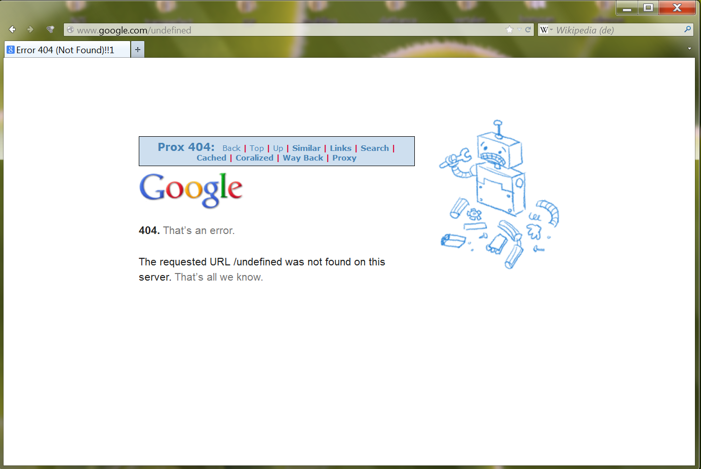

I deactivated all Google filters in the Proxomitron filter editor under "Webpage". The problem persists! Means that after I enter a search term on the Google Advanced Search start page, then push Enter and then click on Next on the bottom of the results page, when I click on a search result on this seconf page, I get 404! On the other hand: When I put Proxomitron on "Bypass" instead, everything works perfectly. So, I draw 2 logical conclusions:

Ok. I deleted the whole "Headers" section from the configuration file and tried again. The problem persisted (clicking on an rsult on the second results page yields a 404. After restoring the configuration file, I deleted the whole "Patterns" section and suddenly Google worked again. In my opinion, this means that one or more of the filters of the "Web page" ("Patterns") section cause the problem, but not the Google filters themselves (please compare my last posts).

I'll guess that you have found an ajax, http://en.wikipedia.org/wiki/Ajax_(programming) , Google page that does not use a "#" in the address.
The "undefined" in the 404 for www.google.com/undefined makes me think there is a broken script on the refering page.
