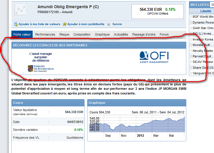

The ads inside the "<div id="XXXXXBoursorama_Block53" class="block">" div are alike this:
<td align="center">
    <a href="http://ads.boursorama.com/call/cliccommand/4484160/[timestamp]?">
    <img src="http://s.brsimg.com/static-1323966476/i/logo/partenaires/opcvm/logoOFIAM-15122011.jpg">
    </a>
</td>
The filter seems to be hit (in test window), but « style="display:none" » doesn't do its job. Doesn't work either when manually added in the div through Firebug.
Edit: For example page http://www.boursorama.com/bourse/opcvm/o...=MP-828485 , see ads on attached image.

Jul. 06, 2012, 06:06 PM (This post was last modified: Jul. 06, 2012 08:19 PM by JJoe.)
RE: Filter to hide ads panel on specific site
Try removing "www.boursorama.com/" from your Bypass-SSL list.
After adding "www.boursorama.com/" to my Bypass-SSL to my Bypass-SSL list:
Open the Proxomitron's Log window. Right click on the window, enable "HTML Debug info".
Load http://www.boursorama.com/bourse/opcvm/opcvm.phtml?symbole=MP-828485 . Browser window shows no filtering.
Proxomitron's Log Window shows "BlockList 16226: in Bypass-SSL, line 18". My line 18 is www.boursorama.com/ . Wink
Remove, comment out, or modify line 18 to "www.boursorama.com:" .
Reload http://www.boursorama.com/bourse/opcvm/opcvm.phtml?symbole=MP-828485 . Browser window shows filtering.
Disable "HTML Debug info" in the Proxomitron's Log Window.
Reload http://www.boursorama.com/bourse/opcvm/opcvm.phtml?symbole=MP-828485 . Browser window shows ads gone.
