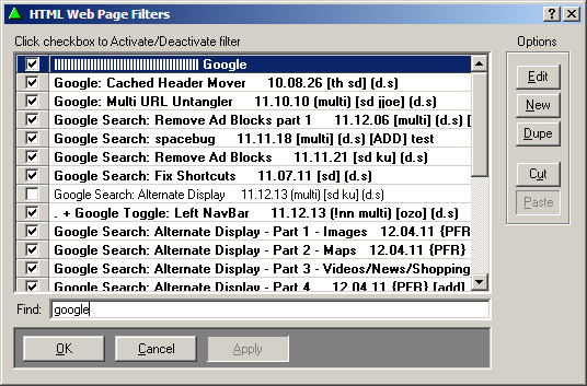

Tried with prox-config-sidki_2011-12-22rc1 in Light Mode with your "google updates".
The good news (but with a caveat):
Palemoon and Opera work ok provided the filter ". + Google Toggle: Left NavBar"
is checked (and placed just above your "Google Search: Alternate Display - Part 1")
If this filter is not checked, the left nav-bar "seeps" through the search results.
So, somehow this Left NavBar filter interferes and does not play nice.

The google filters I have checked at this time are shown in the two attachments:
.png  google1.png (Size: 14.3 KB / Downloads: 752)
.png  google2.png (Size: 13.71 KB / Downloads: 758)
