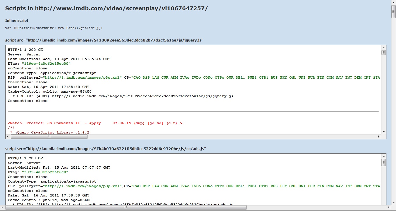

It can be but you probably didn't do something like this http://i.media-imdb.com/images/SFb4b030a632105db0cc5322dd6c9320be/js/cc/ads.js?prx-command=dbug..
Quote:Is there a step by step method for discovering the cause of issues like these where the goal is to minimize the limits placed on the filter?
I went to http://www.imdb.com/title/tt0246578/ , clicked the button that took me to http://www.imdb.com/video/screenplay/vi1067647257/ , and found that the video did not load.
Added "i.media-imdb.com/ $SET(0=a_js.)" and eventually video loaded. It appeared to be a problem with an external script from i.media-imdb.com/
Commented out i.media-imdb.com/ entry.
Opened the set's menu and clicked on "show 33 scripts".
"Scripts in http://www.imdb.com/video/screenplay/vi1067647257/" opened.
The second external script shown was http://i.media-imdb.com/images/SFb4b030a632105db0cc5322dd6c9320be/js/cc/ads.js.
dbugging "ads.js" lead me to "Remove: Ad Functions II - Code 10.08.08 [jd sd] (d.3 l.3)"
Added i.media-imdb.com/images/[^/]+/js/cc/ads.js $SET(0=a_adfn2.) to Exceptions-U
Cleared browser's cache
Watched trailer
Your browser may allow a trick that may make things easier. When you suspect a problem with external scripts, clear the browser's cache, enable "HTML Debug info" via the Proxomitron's log window, and then click "show ?? scripts" in the set's menu. The "Scripts in" window may show dbug for all the external scripts.
Also, the browser's Error Console may help and there are things like Firebug.
.jpg  ScriptsInDbug.jpg (Size: 206.55 KB / Downloads: 1009)
The second external script shown was [url=http://i.media-imdb.com/images/SFb4b030a632105db0cc5322dd6c9320be/js/cc/ads.js]
How did you know to pick that one out of the 33 shown?
Quote:dbugging "ads.js" lead me to "Remove: Ad Functions II - Code 10.08.08 [jd sd] (d.3 l.3)"
Of all the things matched on that dbug page, how do you know which one?
Quote:Your browser may allow a trick that may make things easier. When you suspect a problem with external scripts, clear the browser's cache, enable "HTML Debug info" via the Proxomitron's log window, and then click "show ?? scripts" in the set's menu. The "Scripts in" window may show dbug for all the external scripts.
It does work, but it's still 35 scripts, each one with many matches to choose from. How to know which one?

Quote:If you had just discovered that the video would not load, how would you know to do this?
I would suspect (educated guess) a problem with an external script. The "Scripts in" window would show 16 external scripts from "i.media-imdb.com" and 1 from "www.google-analytics.com". I would doubt the problem was with "www.google-analytics.com". So, I might add "i.media-imdb.com/ $SET(0=a_js.)" to test my guess or simply examine the files.
Quote:It was already in your list?
No, I added it to test my guess and your "solution". I had to disable it and clear the browser's cache to be able to see the broken code again.
Quote:How did you know to pick that one out of the 33 shown?
Quote:Of all the things matched on that dbug page, how do you know which one?
Curiosity, "ads.js". Wink While examining the file, I saw code for flash and many matches for "Remove: Ad Functions II - Code" (which has caused problems before).
Had I not been curious, I could have searched the files for the flash code. For example, "flashvars" is only found in "ads.js".
Quote:It does work, but it's still 35 scripts, each one with many matches to choose from. How to know which one?
I see it as a puzzle like twenty questions, http://en.wikipedia.org/wiki/Twenty_Questions . As we learn and gain experience, we ask better questions.
