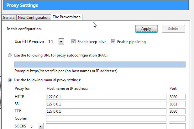

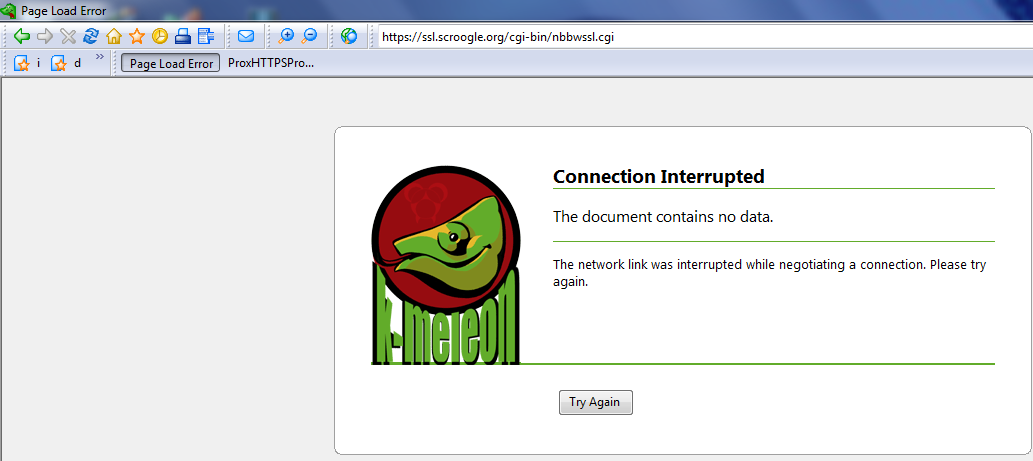

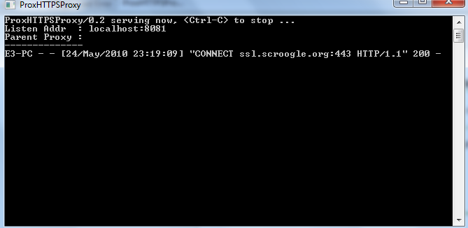

RE: ProxHTTPSProxy, a Proxomitron SSL Helper Program
(May. 25, 2010 02:49 AM)whenever Wrote: Please let me know if there are more need to remove. Haven't you had enough of me yet? ![]() Scroogle search with KMeleon set to Browser's HTTPS -> ProxHTTPSProxy Browser's HTTP -> Proxo other browsers work with same settings. Scroogle1.png (Size: 34.56 KB / Downloads: 892)
The referer header that I think may indicate a need for a filter is shown in Proxo's log Code: GET /scget.html HTTP/1.1Proxo can hide us from /scget.html but what about http://ssl.scroogle.org:443/sslnote.html? Couldn't a simple script detect us? document.location.href? Enough for tonight. |
