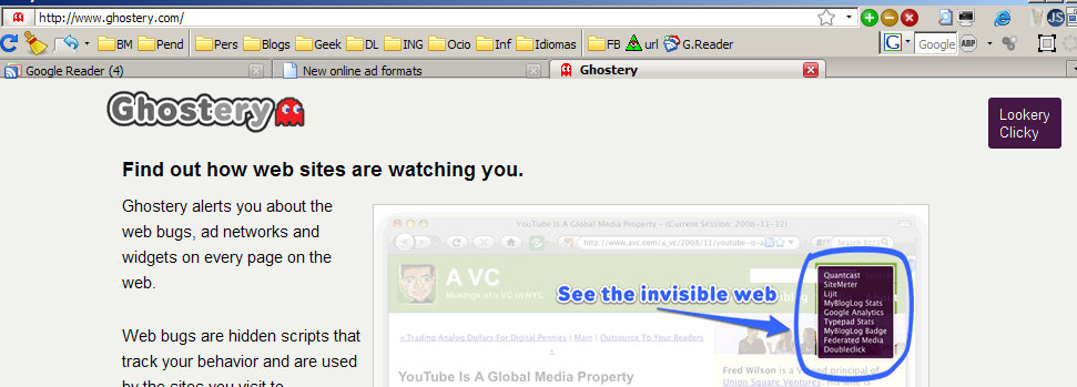

Graycode, the extension also advice us about his page. I add a screenshot
Sidki, upper right appear a violet box with the systems tracking us. Also i use this other extension to see the styles and scripts loaded. Here it is useful for doing some fast search

Yep, and often the hints in the violet box are sufficient, but sometimes the displayed name, like "Dotomi", isn't part of the tracking code. So, i would wish to also get information about the actual code being matched, like "dmpub.com".
But it's okay now, the matching expressions are in "db.js", which is readable.
