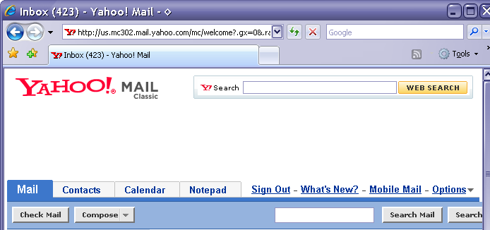

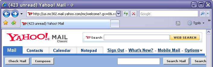

(May. 26, 2009 02:15 AM)soccerfan Wrote:  Hi OZO, do you also have the following (either in IncludeExclude.ptxt or IncludeExclude-U.ptxt):
mail.yimg.com/d/combo\?*/darla.js    $SET(0=a_adfn1.a_adfn2.i_loc_j:0.)
I've added it right below the lines mentioned earlier and it works! Thanks!
Just to make it easier to those who will need it to repeat - now in IncludeExclude.ptxt instead of the line
[^/]++.mail.yahoo.com/            $SET(0=a_rdlink.a_jsmeth.)
(it's commented now) put these lines:
[^/]++.mail.yahoo.com/            $SET(0=a_rdlink.a_jsmeth.a_redir.)
  $SET(sUserJSB=try{YAHOO.ads.renderer.ComplexScriptRenderer._setupRender();}catch(er){})
There is one drawback though. The last line adds a lot of empty space in Yahoo page. Compare two images:
.png  Yahoo-01.png (Size: 20.14 KB / Downloads: 804)
1-st was taken without the line
.png  Yahoo-02.png (Size: 22.55 KB / Downloads: 758)
and the 2-nd one when the line is added. It's not a big deal, but I think it can be fixed.
