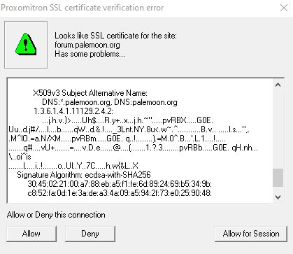

I see it.
The error is displayed for certs that use "SCT List".
The error dialog shows unexpected characters where I think the SCT list values should be.
.jpg  CertErrorSCTList.jpg (Size: 31.6 KB / Downloads: 29)
There are 'expired' dates in SCT List. Could the routine be confused by them...
