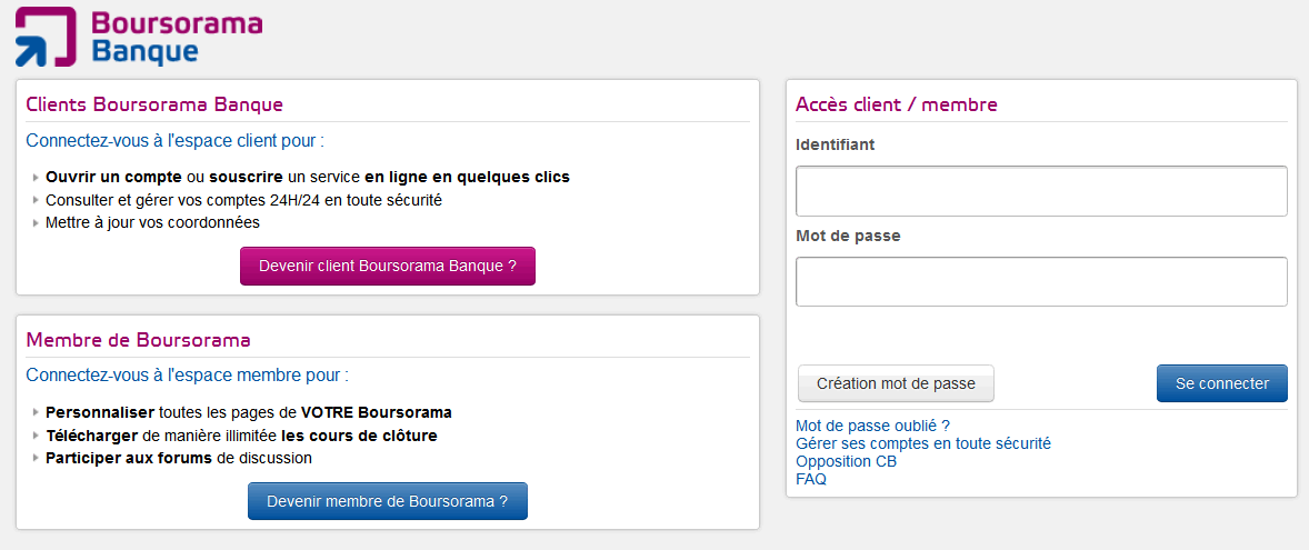

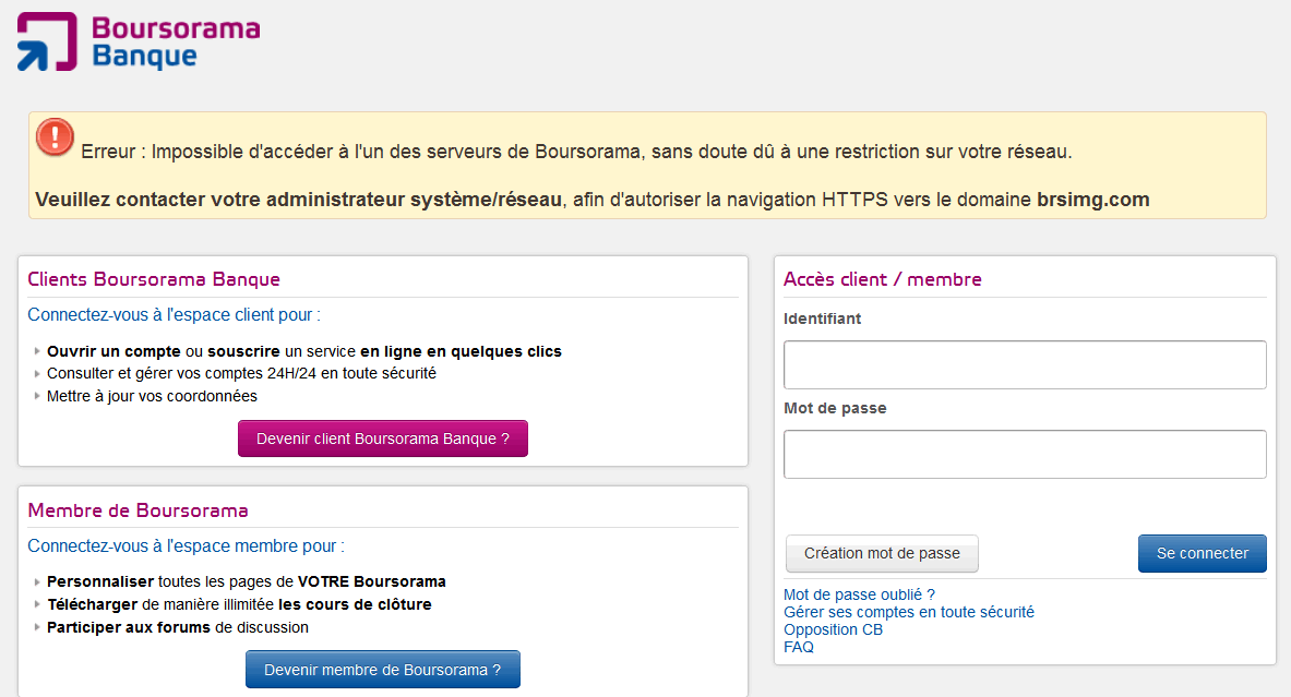

This page should look as "0_boursorama_normal.gif " attached, but it is broken (1_boursorama_broken.gif).
The yellow warning banner says "Error. Unable to connect to 1 of our servers. You must allow access to brsimg.com".
Though, this entry is in my Exceptions-U, so ??
Issue is corrected when I "allow all JS" in proxo-menu or untick "7.2 Block 3d-party" filter.
I do not understand what's wrong.

Jun. 03, 2013, 03:16 PM
RE: Exceptions-U entries not working
The browser shows you
https://www.boursorama.com/ ....... but the Proxomitron sees
https://www.boursorama.com:443/
http://prxbx.com/forums/showthread.php?t...2#pid17132
So you may need
Exception-U entries:
[^/]++.boursorama.com:      $SET(0=a_embed.a_flash.a_java.i_ssl_h:0.a_ssl_q.a_js.i_script:0.a_cookie.)
s.brsimg.com:            $SET(0=a_js.i_script:0.)

Jun. 03, 2013, 08:29 PM
Thanks, JJoe.
As for the JS issue, the colon in place of slash did the trick.
I now have, in Exception-U:
[^/]++brsimg.com:    $SET(0=a_js.i_script:0.)
[^/]++.boursorama.com/      $SET(0=a_embed.a_flash.a_java.i_ssl_h:0.a_ssl_q.a_js.i_script:0.a_cookie.)
