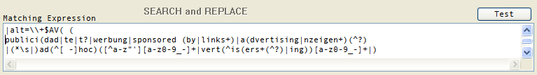

RE: sidki-config: Feb 13 2009
.png  accents_prox.png (Size: 6.66 KB / Downloads: 370)
.png  syntax error.png (Size: 5.63 KB / Downloads: 269)

That's the standard message if something in the editor isn't quite kosher.

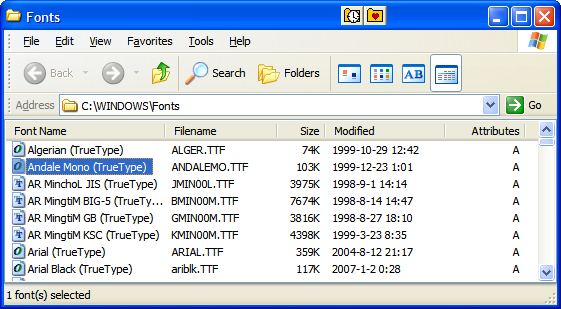

May. 25, 2009, 02:29 PM
Quote:You do have that font installed, right?
Yes, I do have that font installed. You can see from the accents_prox.png that the number zero has a dot in the center.
.png  font_andale_mono.png (Size: 32.65 KB / Downloads: 286)
