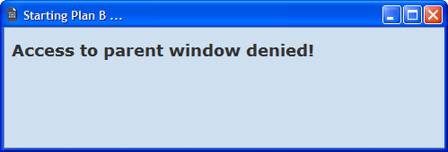

I got below error under Opera Version 10.00 Alpha Build 1456.
.png  error.png (Size: 7.46 KB / Downloads: 338)

I assume this means that posted code is required for Opera 9 stable.
Regarding Opera 10: I've (temporarily) installed the version you're using. Its same-origin policy appears to be quite similar to IE7, so implementing the fix wasn't difficult. Hopefully it works for others too.

The update fixed the prox menu issue. Smile!
