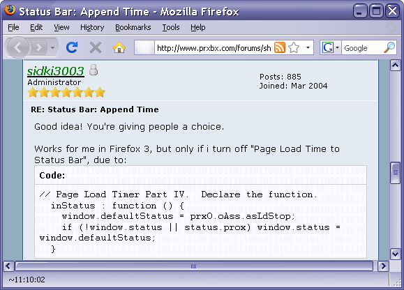

Good idea! You're giving people a choice.
Works for me in Firefox 3, but only if i turn off "Page Load Time to Status Bar", due to:
// Page Load Timer Part IV.  Declare the function.
  inStatus : function () {
    window.defaultStatus = prxO.oAss.asLdStop;
    if (!window.status || status.prox) window.status = window.defaultStatus;

(Mar. 01, 2009 10:21 AM)sidki3003 Wrote:  Good idea! You're giving people a choice.
Hmm. It should run completely independent. And it does so in my environment. Look at this picture:
.png  SB-Time_01.png (Size: 31 KB / Downloads: 385)
As you can see the option "Page Load Time to Status Bar" is on.
Here is another picture. Now it's with "Page Load Time to Status Bar" option off:
.png  SB-Time_02.png (Size: 30.75 KB / Downloads: 371)
It's FF v3.0.5 (in case if it matters).
