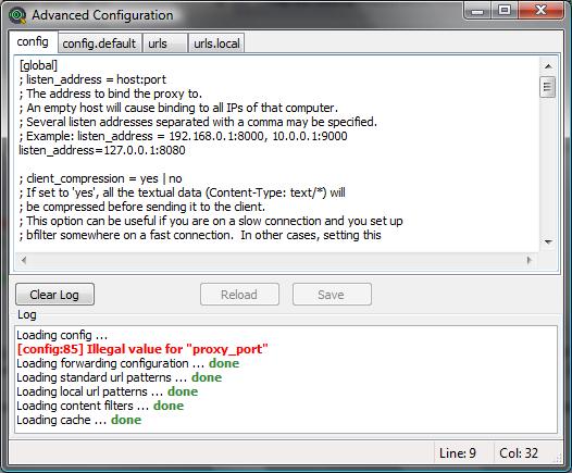

"proxy_port" error
Dec. 25, 2008, 11:13 AM
"proxy_port" error
.jpg  error-proxy_port.jpg (Size: 51.38 KB / Downloads: 282)
Dec. 25, 2008, 12:14 PM
RE: "proxy_port" error
proxy_port doesn't have anything to do with listen_address. proxy_port is used for forwarding traffic to yet another proxy. I don't think you are actually doing that, so just find that line (the error message says it's line 85) and remove it.

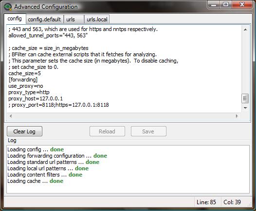

Jart, thank you very much for the quick reply. I commented out the last line (line 85) in the advanced config:
; proxy_port=8118;https=127.0.0.1:8118
and the error no longer appeared. Thank you for the tip.
Despite the setting "use_proxy" is set to "no", is there a reason why BFilter still tries to forward to another proxy and why I was getting the error?
Thanks again, Jart.
.jpg  adv_config.jpg (Size: 44.48 KB / Downloads: 302)
