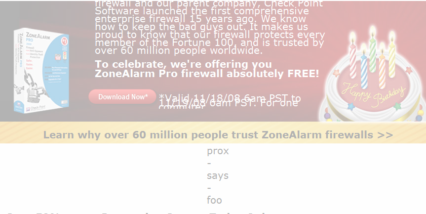

"Prox says foo" ----what the heck is THAT??? I get that message, even when BYPASSING Proxo or unchecking webfilters. I get it on Fx, IE and Opera when trying to get the free Zone Alarm offer.
http://download.zonealarm.com/bin/free/sum/index.html
Finally, after I switched to Scott's default config, that message disappeared and I was able to get a popup box to fill out for the offer. They are overwhelmed so no longer allowing downloads, but asking for name and email address and they are going to send a link for download after the 24 hour offer is over.
I figured Proxo was not allowing the popup but even when I bypassed or unchecked web filters I still couldn't get the popup. I've noticed other times that bypass doesn't seem to do anything if Sidki's filters are being used. Wonder why that is? Bypass isn't really bypass?
IE6 gets hung on that page. Actually, Opera 9.62 was the only browser (and I also tried IE8 and Fx3 on a virtual machine) that was able to give me a button to submit but it too was producing "Prox says foo" until I closed Opera, then switched to Proxo default config (Scott's last). The log was not recording any activity on the ZA page as long as Sidki's filters were being used or even bypassed. I had to switch to Scott's to even see activity on the log. That seems weird.
Anyhow, is the "Prox says foo" an "easter egg" sort of thingy that Sidki put in there?

The dashes are part of that text, it's "prox-says-foo".
Doing a google search it seems that phrase is used in 2 Sidki filters:
Name = "<img>...: Risky Protocols to Link     7.05.24 [sd] (d.1)"
Name = "<div> Remove: Floating Layers     7.07.06 [jd sd] (d.3 l.3)"
Beyond that I can't help, especially about the bypass issue.

"sounds like" a floating layer...
did you clear your cache before refreshing with Proxo in bypass?

Ahh....thanks. That was a floating layer it was removing. I've used Sidki's filters for over three years and never before encountered either of those that would give that message.
As for the bypass issue, usually I just refresh the page after either unchecking Web Filters or checking Bypass. Maybe sometimes I should be closing the browser and reopening? I wonder if that varies by browser or what? Having to close Fx with 45 tabs loaded so I can bypass Proxo for one tab is not something I want to do. That's ok for IE or Opera where I don't have many tabs loaded. Plus, if I had to close Fx and then reopen with Proxo bypassed what a mess that would be with 45 tabs and all of them trying to load third party cookies and Fx popping up an "ask me" box about each cookie...it would take forever to load all the tabs. I know I can switch configs and not need to close the browser and then reopen so bypassing/unchecking Web Filters should also work without needing to shut down the browser.
