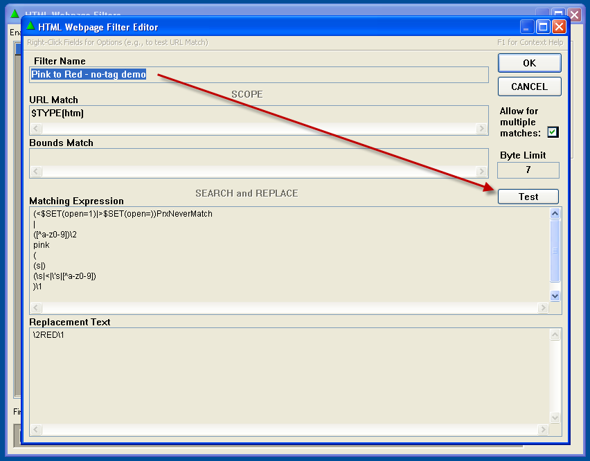

Line 1 checks for the beginning of a tag and sets a variable to "1" when the start of a tag is matched and empties the variable when an end of tag is matched.
It does not "instructs it not to match anything while the variable is set to '1'"
(<$SET(open=1)|>$SET(open=))PrxNeverMatch
or
(<$SET(open=1)PrxNeverMatch|>$SET(open=)PrxNeverMatch)
Line 5 is the parenthesis that starts the part that places things following "pink" into variable "1"
Line 7 requires pink(s|) to be followed by:
a space
a <
an 's
a character that is not a letter or digit.
Line 9 does not match when called while inside a tag.
(^$TST(open=1)) "NOT if open is 1".
For visual clarity. Seems to have worked.

in the web filter editor page, there is a "TEST" option that will show you how "fast" your filter 'parses' your input, if you wish to "test" the speeds of the two methods, we'd be delighted to hear the results Big Teeth
.png  pink2red.png (Size: 38.31 KB / Downloads: 754)

I tried it (not sure I did it right), with these results:
pink((s|)
Sample Text: 30000 bytes
Successful Matches: 27
Avg time: 2.969000 (milliseconds)
((pink|pinks)
Avg time: 3.140000 (milliseconds)
So yes, a bit faster.
It's a little comforting that (pink|pinks) will work though because the other method still doesn't make sense to me. It seems like it should be pink(|s) if anything.
