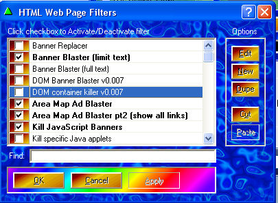

when you open up your "webpage filters", does one of the very top few filters say anything about the year/month/day that the config was released?
Aug. 16, 2008, 04:50 AM
RE: Proxomitron Won't Allow YouTube
No. Here is a screen shot of what I see, if I am looking in the right place.

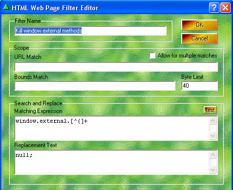

There is a filter from the original default.cfg file that was blocking the videos in YouTube, and that problem started recently. The filter is Kill window.external methods, and the domain blocked is ytimg. I had to make an exception to filtering that domain with that filter.

(Aug. 16, 2008 05:19 AM)Siamesecat Wrote:  There is a filter from the original default.cfg file that was blocking the videos in YouTube, and that problem started recently. The filter is Kill window.external methods, and the domain blocked is ytimg. I had to make an exception to filtering that domain with that filter.
I’ll attach a screen shot of my Kill window.external methods filter to this post, so that what I have can be seen. If you can provide the code to place in there, that would help.
