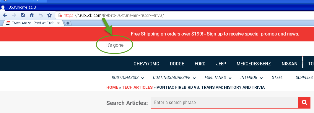

Does this filter
Name = "Remove logo"
URL = "raybuck.com/firebird-vs-trans-am-history-trivia/"
Limit = 512
Match = "<div class=$AV(logo-tagline-container)*</a> </div>$STOP()"
Replace = "It's gone"
remove the Raybuck auto body parts logo and parts search box at the top of https://raybuck.com/firebird-vs-trans-am-history-trivia/?

(Feb. 18, 2022 02:31 AM)JJoe Wrote:  But you did have to solve the captchas to reach the site?
Yep, had to solve the captcha (twice).
Feb. 18, 2022, 03:53 AM
Post: #88
RE: prox-config-sidki_2019-01-26b1
(Feb. 18, 2022 02:31 AM)JJoe Wrote:  Does this filter
Limit = 512
Yes. Only in the CloudfairTest.cfg (as I cannot load raybuck.com in anything but it).
