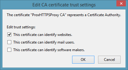

Jan. 04, 2015, 06:34 AM
Post: #52
RE: ProxHTTPSProxyMII: Reloaded
When importing, you should check all three checkboxes like me, here you can recheck it again:

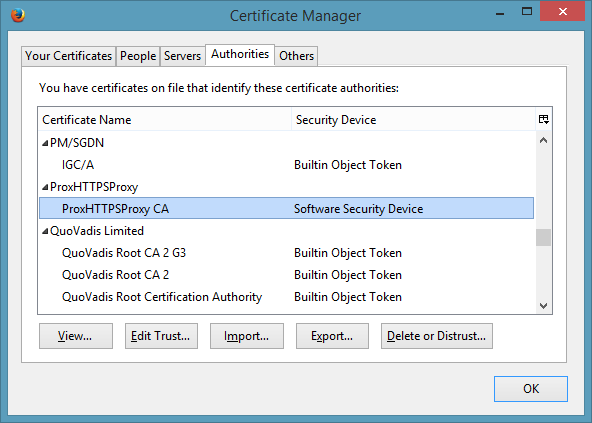

I never got those options. See pic. This is where I tried to import. It says it's already installed (though I think I originally imported it from the "your certificates" tab.
Jan. 04, 2015, 07:14 AM
Post: #54
(Jan. 04, 2015 07:08 AM)zoltan Wrote: I never got those options. See pic. This is where I tried to import. It says it's already installed (though I think I originally imported it from the "your certificates" tab. You can find ProxHTTPSProxy CA from your Certificate Manager and Edit Trust, tick all three. |

I found the certificate under Servers. After clicking edit trust, "Do not trust the authenticity..." was checked. I changed it to trust, then under edit, I checked the 3 boxes. Now, after closing it and reopening, it's no longer under Servers.
Jan. 04, 2015, 07:27 AM
Post: #56
You should delete that cert from Server and Import it to Authorities, and only Authorities, not any other tab.
Jan. 04, 2015, 07:41 AM
Post: #57
But like I said, it's no longer in the list, either in Servers or Authorities (though there is a "CAcert Inc". So I tried importing it to Authorities and still get the "already installed" message.
However, I can now open HTTPS pages without the "untrusted" error. Except for yahoo mail which claims "the browser you're using refuses to sign in (cookies rejected)" |
Jan. 04, 2015, 09:33 AM
Post: #58
If it's "already installed", you should could find it in the list.
BTW, it's enough for the program to work to trust it for websites only. 2015-01-04_173101.png (Size: 4.47 KB / Downloads: 871)

It finally showed up under authorities, but only after restarting the computer. It seems to be filtering https pages, so I suppose it's working properly. The Certs folder is filling up with lots of .crts from various sites if that indicates anything.
