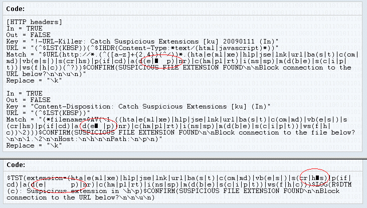

Is it just me or is there odd characters in the filter codes?
.gif  Prxbx_Codes.gif (Size: 71.22 KB / Downloads: 1022)

Graycode, yes, we are having problems with the strings inside the code tag. Maybe the solution could be forum would not not wordwrap inside code.
Sidki spoke me about URL-parser and the uExt variable. So to be more general, better use $TST(uExt= instead of $TST(extension= in the code of my above post.
Edited: 090128
