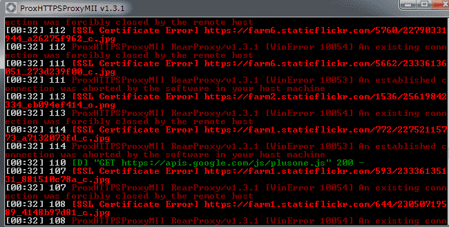

Apr. 04, 2016, 04:53 AM (This post was last modified: Apr. 04, 2016 05:00 AM by zoltan.)
Post: #142
RE: ProxHTTPSProxyMII: Reloaded
(Apr. 03, 2016 04:28 AM)JJoe Wrote:  I see the errors at 'login.yahoo.com' and 'www4.symantec.com/Vrt/offer?a_id=175670' while using ProxHTTPSProxyMII v1.3.1 (urllib3/1.12). I do not see them while using the py version, ProxHTTPSProxyMII v1.3.1 (urllib3/1.14). So, the updated urllib3 may be the solution to some cert errors.
Not sure I understand about the update. I don't see a version 1.14. Maybe I'm overlooking something. The versions I downloaded were:
1.3a - 1.10.4 (posted May 27 '15)
1.3.1 - 1.12 (posted Oct 1 '15)
The latter is the one referenced in my post above. As an experiment, I tried 1.3a - 1.10.4 and it was much worse. There were "connection is untrusted" errors on the first 4 urls I tried (google, wunderground, flickr, and yahoo mail).
(Apr. 03, 2016 04:28 AM)JJoe Wrote:  For example, blog.mingthein.com's server is returning '404 not found' for some resources. Sidki's set redirects these and closes (aborts) the connection.
hmmmm. In version 1.3.1 I'm definitely getting SSL errors on that page that are blocking the pics. See attachment for log example.
After adding all those "farmX.staticflicker.com" urls to the no-verify list, the page loads as it should.
.gif  ssl-thein.gif (Size: 18.22 KB / Downloads: 748)

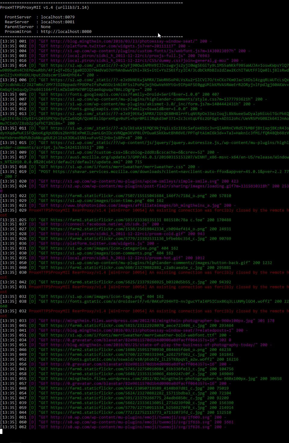

Apr. 04, 2016, 07:07 PM
Post: #143
(Apr. 04, 2016 04:53 AM)zoltan Wrote:  Not sure I understand about the update. I don't see a version 1.14. Maybe I'm overlooking something.
You would need to install Python and use 'ProxHTTPSProxyMII_py 1.4.zip' from http://prxbx.com/forums/showthread.php?t...9#pid18719 .
(Apr. 04, 2016 04:53 AM)zoltan Wrote:  hmmmm. In version 1.3.1 I'm definitely getting SSL errors on that page that are blocking the pics. See attachment for log example.
I believe you. The 'an established connection was aborted by' lines in "ssl-thein.gif" appear to be the result of an error not the cause, however. "Content-Type: 2b Kill Image/CSS/JS Error Responses 07.11.09 [sd] (d.0) (In)" closed some of those connections.
I see
.jpg  minglog.jpg (Size: 311.68 KB / Downloads: 722)
