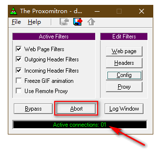

A new bug is caught.
If you have https filtering enabled, clicking Abort while Active connections is NOT 0 will make Proxomitron refuse accepting new connections.
.png  Abort.png (Size: 5.06 KB / Downloads: 560)
While the Aborting is finished, the log window shows below message. Seems to be a ports binding issue.
Listening on port 8443
Listening on port 8080
The problem doesn't appear to happen if you have https filtering disabled (Untick Use SSLeay/OpenSSL in HTTP tab of the settings).
