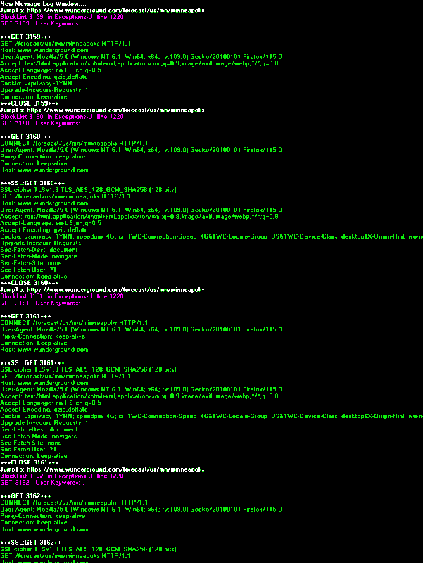

www.wunderground.com    $JUMP(https://www.wunderground.com/forecast/us/mn/minneapolis)
fails with a "page isn't redirecting properly" error. Proxomitron log looks like this. If you scrolll down that log, there are 21 repeated attempts to jump. Most pages seem to behave this way instead of the Bad Cert Domain error I got when Wikipedia was jumped.

RE: Proxomitron Reborn - JJoe - Feb. 04, 2025 04:11 AM
(Feb. 04, 2025 02:01 AM)zoltan Wrote:  For example,
This is as expected. Wink
With $JUMP() the Proxomitron instructs the browser to make a new request to the target URL. The new request is filtered by the Proxomitron. In this case
always matches the request for https://www.wunderground.com/forecast/us/mn/minneapolis. Scott added code (21 repeated attempts) to prevent an endless or infinite loop.
You need to add some code so that the target URL is not matched.

RE: Proxomitron Reborn - JJoe - Feb. 06, 2025 10:20 PM
(Feb. 06, 2025 07:48 AM)zoltan Wrote:  ...
I tried using your new filter as a model for the simpler one:
www.wunderground.com/ $OHDR(Host:www.wunderground.com(^?))   $JUMP(https://www.wunderground.com/forecast/us/mn/minneapolis)
but it still results in "...page isn't redirecting properly"
I don't understand
Does this help?
www.wunderground.com/(^?) $OHDR(Host:www.wunderground.com(^?))   $JUMP(https://www.wunderground.com/forecast/us/mn/minneapolis)
This expression only matches "www.wunderground.com/"
So there won't be a JUMP for www.wunderground.com/morehere.
The $JUMP, as previously constructed, is just like many that I've been using for a long time successfully, so something different is happening
It could be that the reason it worked for you past was that you JUMPed from http to https.
www.wunderground.com/ would not match www.wunderground.com:443/
Due to the popularity of https, amy has made some changes.
Going forward and with your format, I'd expect a loop for $JUMP and no loop for $RDIR.
In the old google expression,
?$SET(0=f_ua_ff.a_js.)
prevented the loop by matching www.google.com/morehere before
$SET(0=f_ua_ff.)$JUMP(https://www.google.com/advanced_search)
could.
$JUMP sends a command to the browser to request an address. The Proxomitron will filter this new request.
$RDIR tells the Proxomitron to request an address itself. So, no browser loop. The Proxomitron won't tell the browser about the redirection.
RE: Proxomitron Reborn - zoltan - Feb. 07, 2025 03:29 AM
That's working perfectly. I used the same format with other sites I redirect and they're working too.
I went back to ProxHTTPSProxy and tested with just https and the redirect worked with:
www.wunderground.com/(^?)    $JUMP(https://www.wunderground.com/forecast/us/mn/minneapolis)
With Reborn, it does require the addition of $OHDR(Host:www.wunderground.com(^?)) That's fine though, as long as I know what to do.
